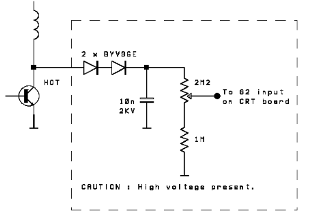

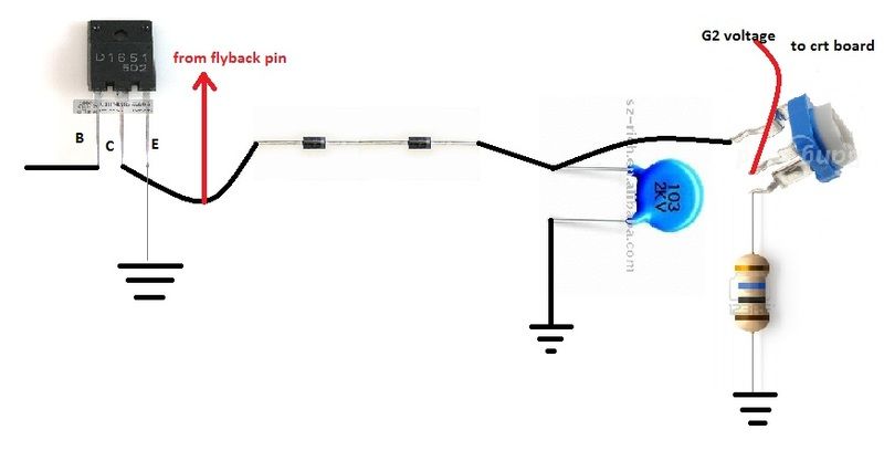

Post by ultrasonic™ on Wed May 21, 2014 1:28 pm
lipat na rin natin to dito
alternative External Screen/G2 Supply
magagamit nyu to pang test at alternative way pag sira o may sayad ang screen supply na nanggagaling sa flyback

ultrasonic™ wrote:lipat na rin natin to dito
parang ganito ang sony tv about g2 voltage nya po master tama ba ako ? heheh

Post by Hertz on Sat Oct 17, 2015 9:46 am
tama. Good example iyan sa lumang model ng SONY
