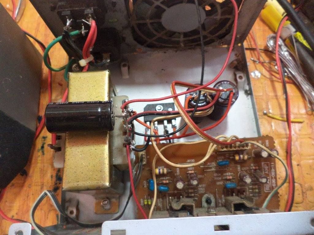

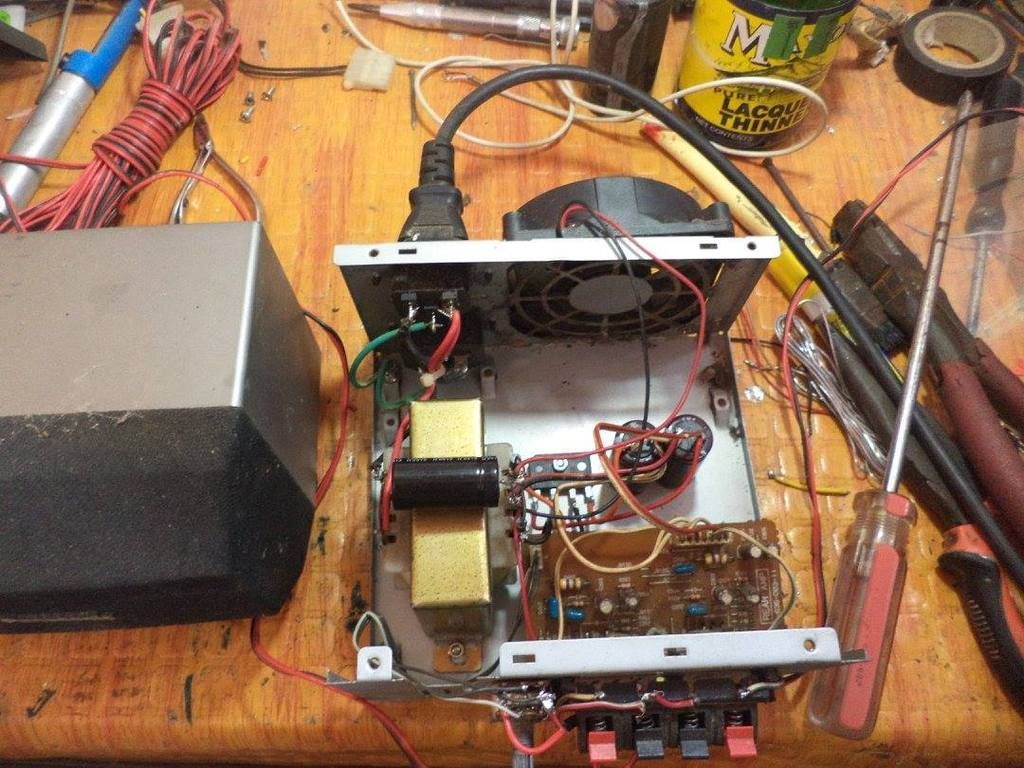

Post by DJFEL on Fri Feb 12, 2016 8:26 pm

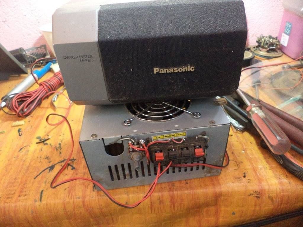

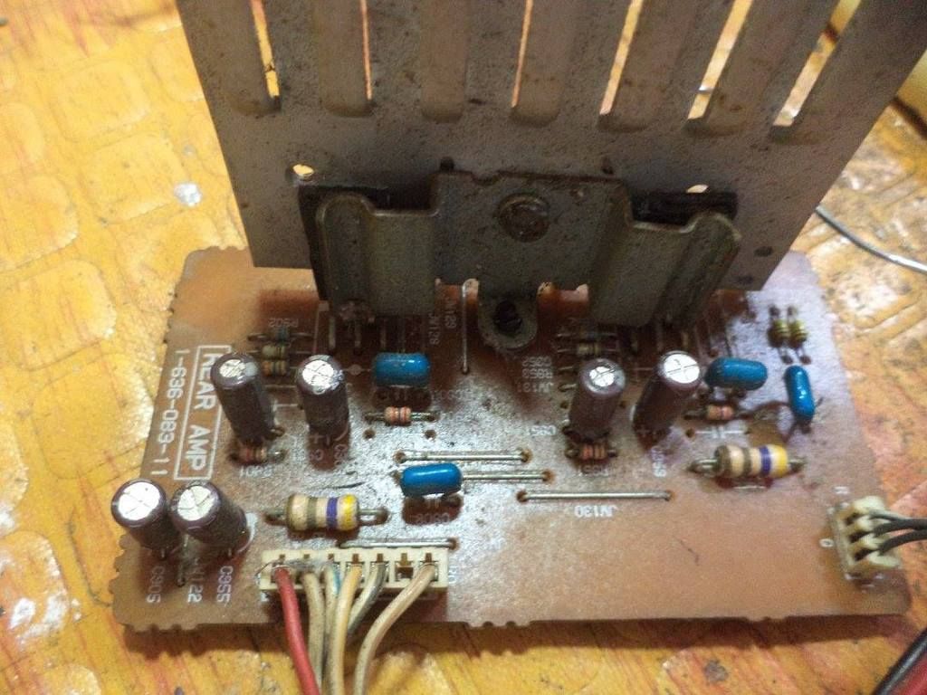

4r sml speaker amp..pioneer to...rear amp...ok pa kasi...12v supply..
eto ginawa ko ngayon...wlang ma gawa kasi..
eto yong pic..
Post by DJFEL on Fri Feb 12, 2016 8:29 pm
power supply casing yong ginamet ko..

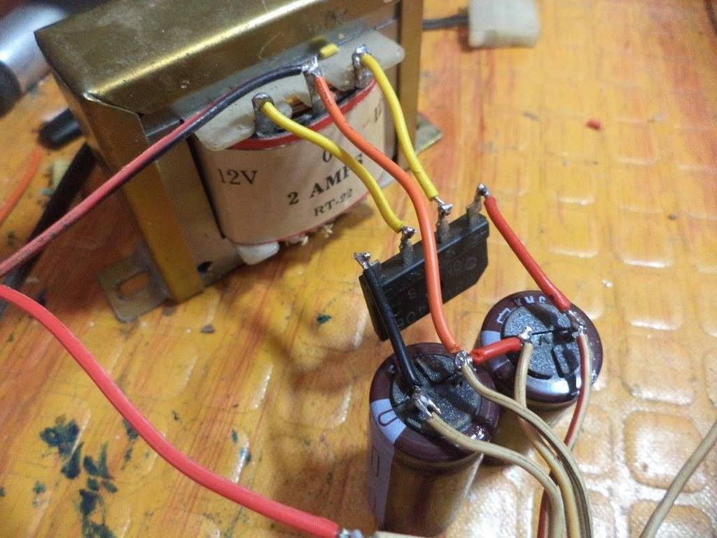

Post by DJFEL on Fri Feb 12, 2016 8:47 pm

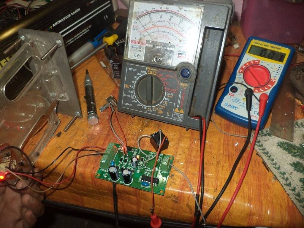

hug player...modify power supply & lines..
eto yong pic...

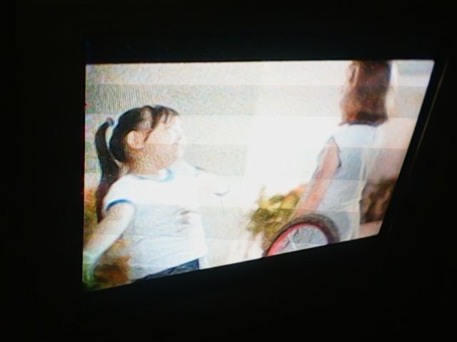

Post by alvinquimbo on Tue May 03, 2016 8:59 pm

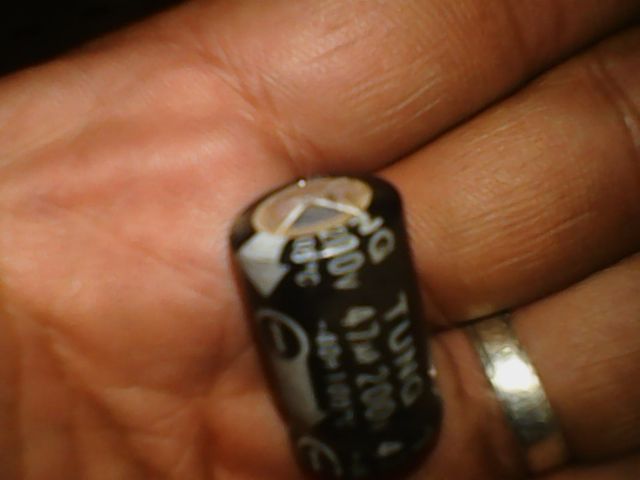

Hi mga sis Share ko lang ito Philips no power.
Ang problema pala ay nasira ang isang e.caps along b+ line, yung dalawang e.caps na magkatabi. kaya pinalitan ko at boom problem solve..kapehan nanaman...
Ito yung pics nya:

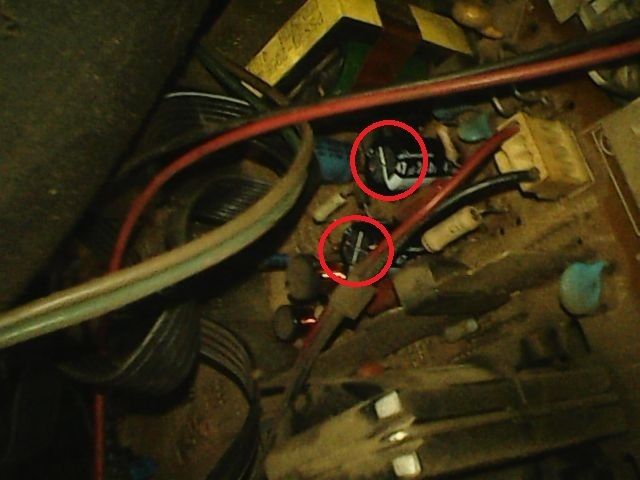

Post by alvinquimbo on Tue May 03, 2016 9:01 pm
Tapos ito ang sira:
Post by alvinquimbo on Tue May 03, 2016 9:02 pm
Ito yung finish product:
Kaya kapehan na....hehehe
Post by ultrasonic™ on Thu May 05, 2016 10:57 am
nice.. common yan sa Philips... SOp check yang dual caps 47uf/160V

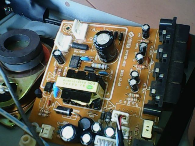

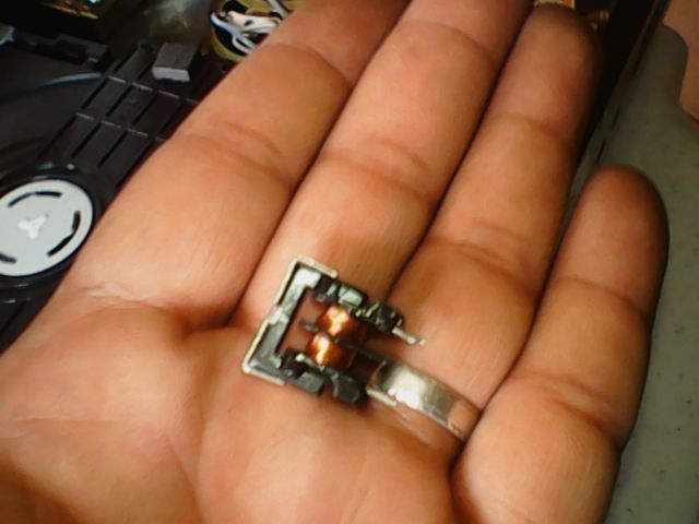

Post by alvinquimbo on Sun May 08, 2016 9:59 pm
Hi mga sis share ko lang DVD player, ang probs ay no power:
Ito yung pic:
Ito ang sira:
Kasali din ang Viper22a sa nasira...Kaya kapehan na naman... Very Happy Very Happy Very Happy
Post by sherlanmamaril on Sun May 22, 2016 8:13 pm
master yang indcutor na yan may nabili kayu???
ako namna kalkal ako kung panu mag interpret sa diagram po

Post by alvinquimbo on Fri May 27, 2016 6:14 pm
wala akong nabili nyan sis..naghanap lang ako sa ibang board..
Post by Electro on Sat May 28, 2016 9:48 pm
Line filter coil yata ang tawag dyan master alvin. congrats po
