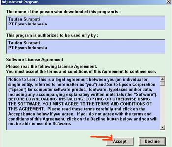

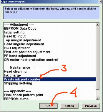

1. Run the program by double clicking resetnya “AdjProg.exe”
2. Then follow the following picture:
3. Select Particular Printer and Port
4. Click on Particular adjustment mode for easy way
5. Turn the printer off then on again. Printer will flame with a full green light. Epson tx111 printer means that blink had been ready for use again.
