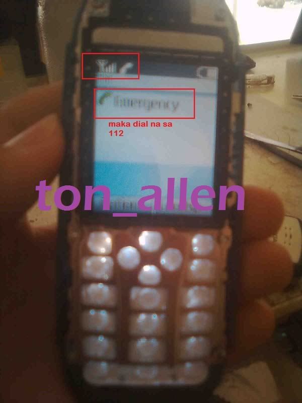

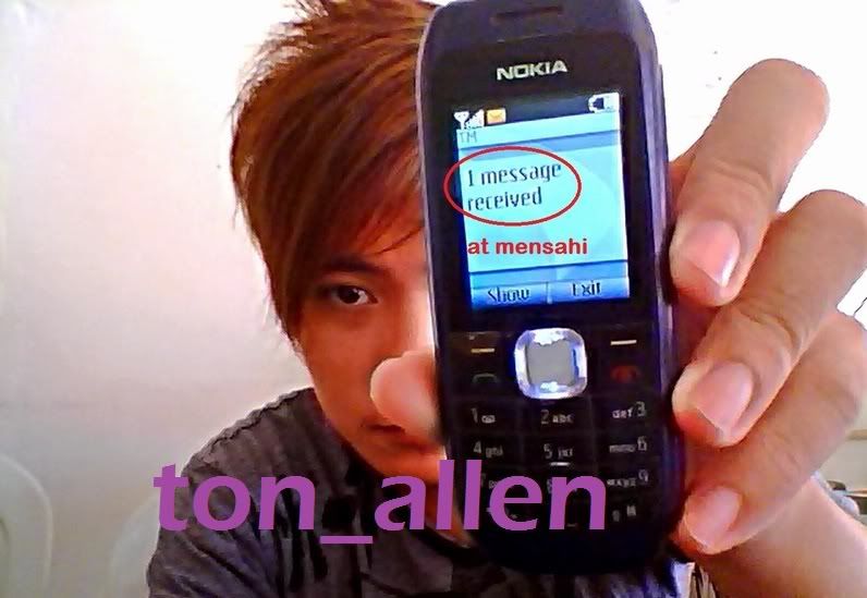

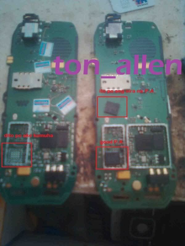

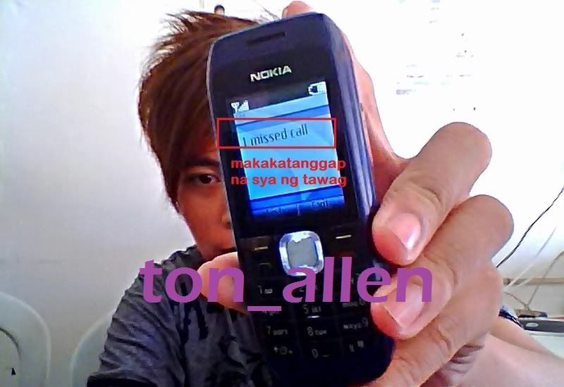

[SIZE="3"]UNIT:[/SIZE] nokia 1616
[SIZE="3"]PROBLEM:[/SIZE] fake signal...minsan walang signal
[SIZE="3"]HISTORY:[/SIZE] nabaksak daw sabi ng customer
[SIZE="3"]ACTION:[/SIZE] 1st: trace ko mga line sa antenna ok nman...
2nd: decide ako palitan P.A
test:
done............
