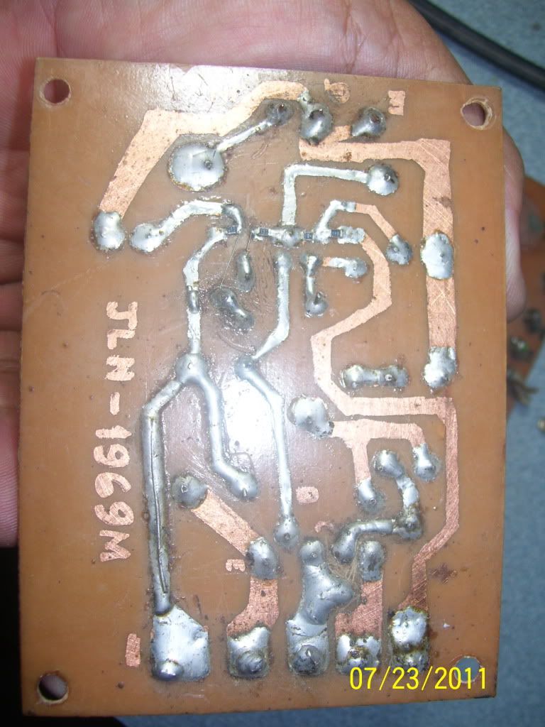

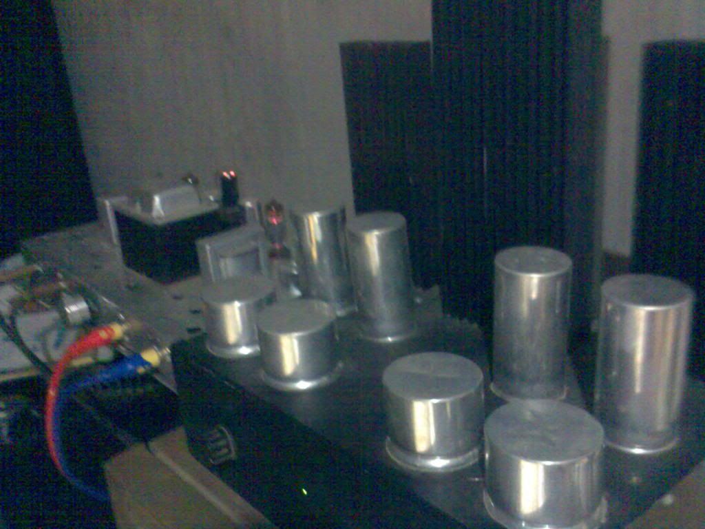

sample of my transistorized JLH class A 10W/ch

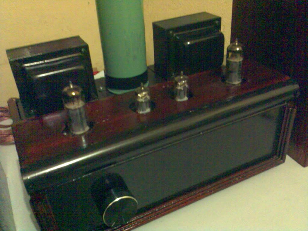

sample of my class A tube
