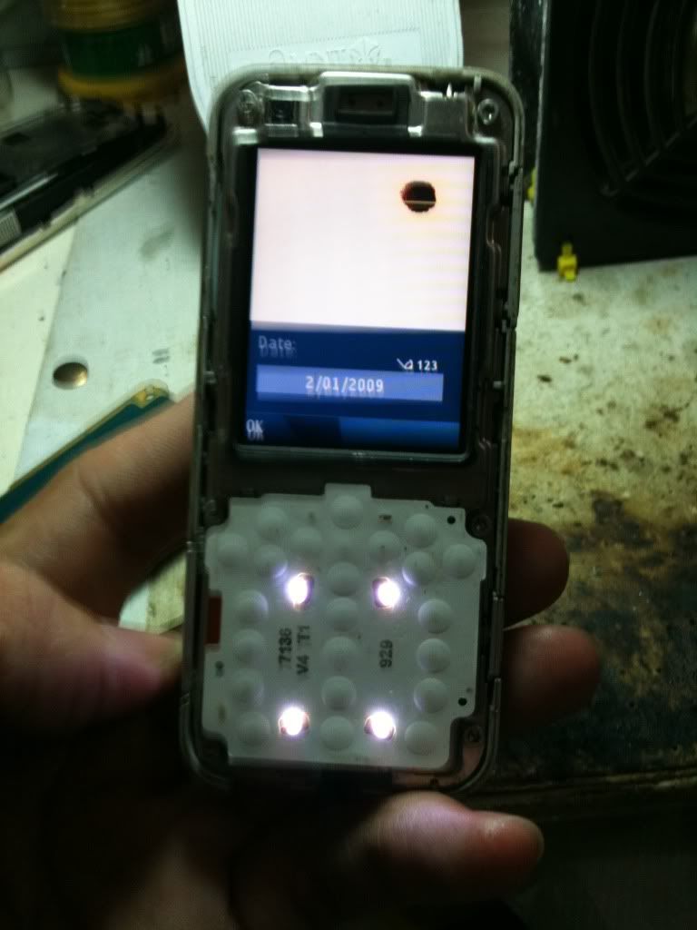

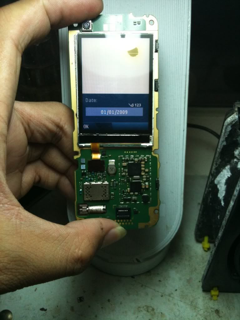

Post by ton_allen on Wed Sep 19, 2012 10:43 am
unit: 6120c
problem: no light
ng galing na sa ibang shop...
action: baklas ko ang unit at pinalitan agad yong betty I.C... Smile
mabuti na lang sapol ka agad Very Happy
