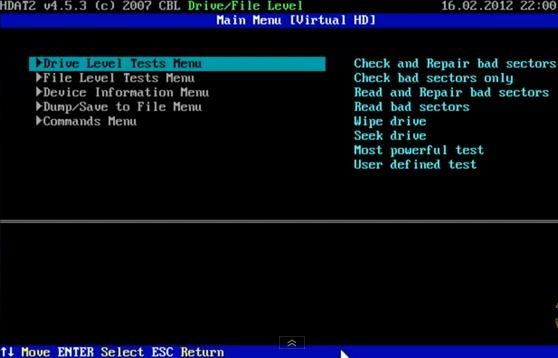

Post by ultrasonic™ on Sat Aug 25, 2012 6:30 pm

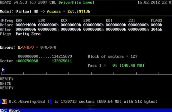

1st DL muna kau ng Hirens BootCD

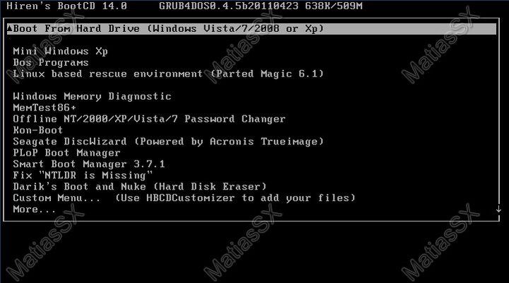

at jan ka mg boot-up

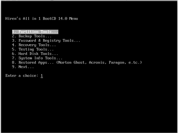

choose DOS program

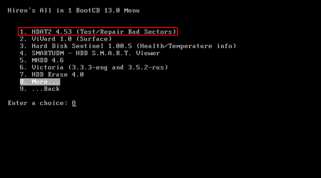

sunod nyu nmng piliin ang Hard Disk Tool

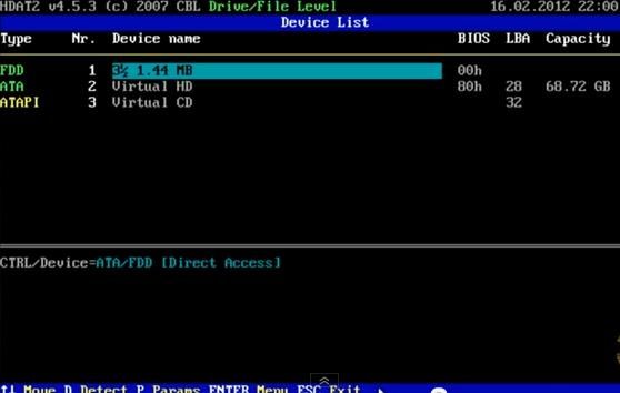

then choose hdat2
mkikita mu na ngayon lhat ng Drives mu..

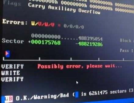

piliin nlng ang name ng HD mu. tapos check & repair Bad sector
magsisimula na yang mgscan at marepair ng bawat sector...
