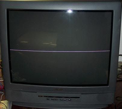

ANO POH PROBLEMA NANG TV KAPAG MAY 1 LINE NA COLOR WHITE SA SCREEN NANG TV??? MGA BOSS

Post by ultrasonic™ on Thu Aug 23, 2012 4:28 pm
nku avoid all capital letters sis..
anung lines ba sis. pa horizontal ? o pa vertical
kng pa horizontal like this
tumuon lng sa vertical section...
check agad ang supply ng vertcal ic
e-check ang input at output
check agad ang Yoke

Post by 143baifern on Fri Aug 24, 2012 11:20 am
gnayan na linya... nasa pix...
paano pag check sa yoke???
vertical ic??? san banda yun mga boss???
turo.an nyo ako plzzzz???
