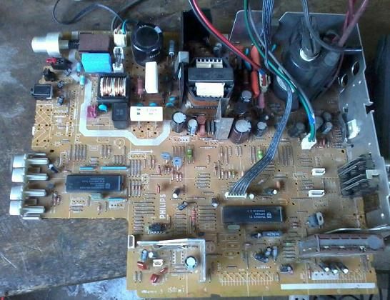

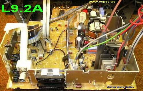

Post by ultrasonic™ on Sat Mar 10, 2012 7:54 pm
Chassis L9.2A AA
Power Reg.: STP6NA60
Pwm: MC44603A
EEPROM : ST24W16BS
System Control: SAA5564PS
Jungle/Chroma : TDA8844
Vertical : TDA9302H
Sound : TDA7053A (stereo 1W), TDA7057AQ (stereo 3W),
HOT: BU1508DX
FBT : AT2078
Chassis L9.2A AA

Master Ultrasonic sir,eto ba yung board ng 21PT3952/71R ng philips?yung match line nila na model?thanks.
jojogreg
Posts : 43
Join date : 2012-10-03
Re: Philips TV ( Chassis L9.2A)
Post by ultrasonic™ on Wed Oct 17, 2012 1:26 pm
uu nmn.. mas madali nlng yan kasi my oscillation khit saglit...
pg ganyan ang scenario be sure agad na ok ang vert. section nyu.. then sunod nyu ang jungle area lalot ang 47/50v kasi isa yan sa common na sakit ng chassis na yan... ang c board din suyod ka rin jan.. pki double check din ng B+ supply nyu kng buo pa rin ba.. 47uf/160...
