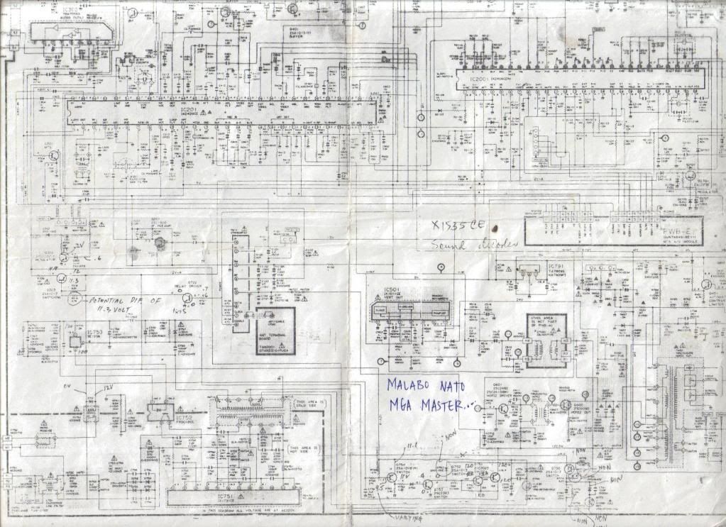

Post by ultrasonic™ on Tue Feb 21, 2012 11:47 am
Sharp Cinemaborg
Model Series
20V-S100
21V-S200
E.Board: DUNTK8490PE, PWBF8490PE, DUNTK9254WE
courtesy of rovericks & DSM ng elab
Reg:  STK73907-T or iX1791CE
EEPROM :
System: IX2406CEN1
Jungle: IX2429CE
Vertical : TA8403K
HOT: 2SD2499
FBT : RTRNF0058PEZZ
Sound : TDA7056A

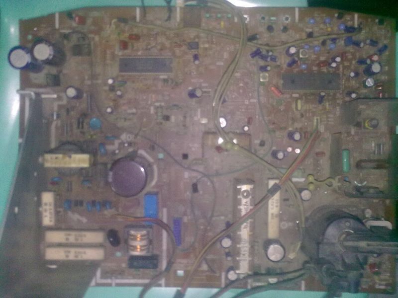

Post by electro+ on Fri May 29, 2015 6:35 pm
Thank you sir Hertz sa password. may problema parin po ako sa cinemaborg 14v-s100 totally dead set po wala rin led lights: voltage test ko sa main capacitor 300v, sa b+155v, rectifier diode forward and reverse infinite at 8ohms, ung apat na transistor sa power supply collector infinite emiter 300k ohms. yung transistor malapit sa horizontal section collector infinite emiter 210 ohms, walang voltage sa b+ capacitor tabi ng flyback, flyback xformer wala rin po voltage, rectifier diode infinite at 8ohms. salamat po sa makakatulong.
