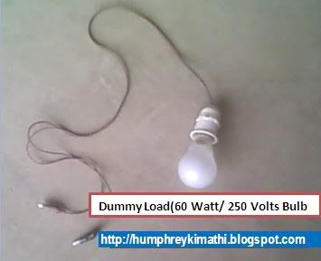

@batmantech pwde kang gumamit ng incandescent bulb method as a dummy load... para bawas putol ng fuse Smile
while nag totroubleshoot
kabit nyu lang sa fuse holder. pag masxadong maliwanag. may heavily load or short pa kau...
