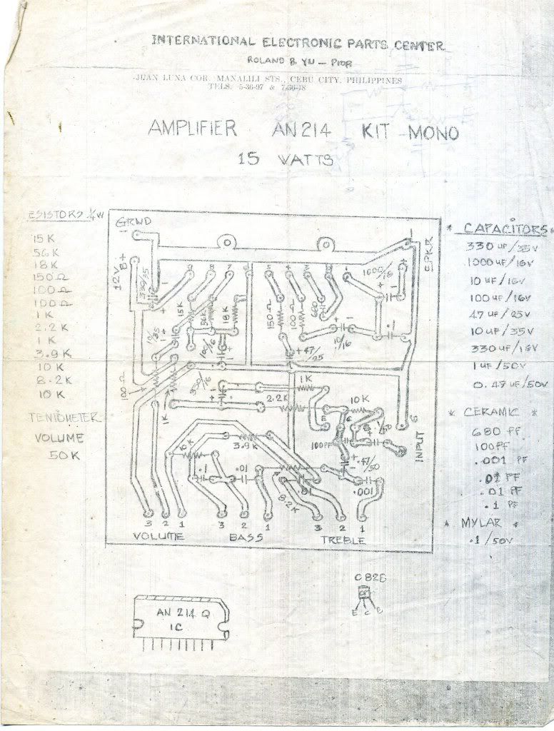

Re: BOOSTER AMPLIFIER (STEREO) using MJ2955
Post by Blaze25 on Mon Jun 18, 2012 12:01 pm
uu nga sino po may modifications circuit diagram ng tones control nito mga sir bass at treble,sayang din kasi 2pcs AN214 q ic ko dito.
Post by 01110011 on Mon Jun 18, 2012 7:44 pm
Blaze25 wrote:uu nga sino po may modifications circuit diagram ng tones control nito mga sir bass at treble,sayang din kasi 2pcs AN214 q ic ko dito.
gawa ka muna ng working na an214 amp, tsaka mo na imodify Smile
Post by Blaze25 on Tue Jun 19, 2012 8:46 am
sino po may pcb layout pa upload po..,wag lang kay pagarigan..
Blaze25
Posts : 16
Join date : 2012-06-18
Age : 43
Location : Carmen North Cotabato
Post by 01110011 on Wed Jun 20, 2012 7:42 pm
courtesy of sir efren from elab Very Happy
Post by 01110011 on Wed Jun 20, 2012 7:43 pm
mods: maglagay ka ng mylar between pin 5 and gnd experiment ng different values
Post by arkin on Fri Jun 22, 2012 1:51 pm
hndi original kp500 circuit Very Happy
