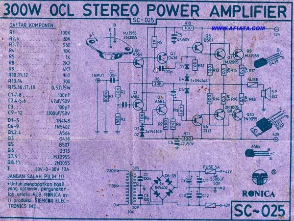

sir rms na ba iyang diagram ? parang hindi yata aabot scratch

uu ngah mga 50-60w lang ata kaya ng mj2955 at 2n3055 pede cguro kung mas malaki voltage pero maxado na pong delikado baka pumutok ;D aware

hmmppfff scratch bka PMPO pa. pero di pa rin aabot eh.. sir trial test ba ito sa amin lol!

^ so nasukat mu ba ang output ? abot ba ang 300W ?

40w lng yan..d kya pu2tok c5 nyan?

dapat ba master arkin. mas mataas pa sa 47/50v

Hi to all im a new user .300watts po b tlaga yn anu pong book ung npagkunan. Prang d po ata 300 kc merun .aq build driver hndi q n i detail msyado mhaba a561 2pair 3h1061 ska 1a761 power trans 4 n 2n3055 .100watts lng ung output .45vgnd45v pla yn pnp.vs.npn ung type

50 to 80 watts rms yan

hnd 300 wats yan d acurate

very sensitive yan..kunting mali sunog ung trannies...

good to see that this thread have a lot of suggestions.. yes all of yours are right, this amp is not a rms base. its only a pmpo. i see this amp when i was surfing in the internet, and I'm so confused to all of the details i have been read, thats why i posted it here to aware the others Twisted Evil
