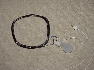

diba hindi magandang gamitin ang permanent magnet ? diba dapat electromagnet. gaya nito
diba mas madaling kontrollin

@pyro iyan ang gamit sa mga SVC shop (^_^
@TS sundin mu lng ang payo sau ni electro.. kng gusto mung magtipid.. ganyan din ang gamit ko pag nasa labas nku ng SVC shop ko... home made
series lng ng 2 or 3 degaussing coil ng tv na pang 25/29"
daan mu lng sa normally open na switch. kng may incandescent bulb kau pwede mu din idaan to minimize the heat... o kng gusto mu pa tlgang fully protected.. daan mu pa sa posistor (^_^),V,,
kng gusto mu nmn ng pangmatagalang babadan ito gawin mu
The degausing coil is a single set of windings of AWG#28 enamel wire
around a 10 to 12 inch form. There must be enough turns to add up
to between 70 to 100 ohms. I would assume about 300 turns at
minimum. The turns must be very tight, but not enough to cause damage
to the wire. It is an open air type inductor. Any metal in its
active field area reacts to it. It is the alternating current through
it that makes it act as a demagnetizer. It is an open air core
induction unit.
In series with the power wire there is a power switch. It should not
be left on for more than about 40 seconds. It will start getting very
hot because it does not have a laminated core to neutralize the
induced eddy currents.
After the windings are made, the coil is baked at about 80 degrees
Celsius for 24 hours to drive out the moisture. Then it is soaked
in transformer laquer for about 20 minutes. After it is hung to dry
for 72 hours, and then baked again at 60 degrees Celsius for another
24 hours. This is to get rid of any moisture and not have any
windings vibrating causing resonance.
You would be better off to buy one ready made...!
