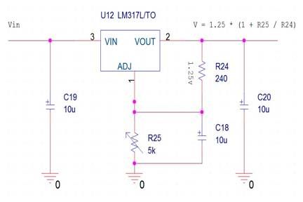

ask ko lang po kung pano po ba yung schematic diagram ng multiple voltages na power supply.
ang pinapagawa po kasi samin 3V,5V,9V,12V at 24V.
regulated power supply,gagamit ng zener diode pati po ng bleeder resistor.tapos dapat daw po walang IC.
paano po kaya yun??[i]

regulated power supply ? pinagbabawal ang ic ? balik na lang sa descrete component
1 transistor H1061
1 zener diode
2 resistor
3 Elec. Capacitor
@sir hertz pahiram ng image Surprised

Post by lynn on Fri Oct 07, 2011 10:40 pm
thank you po.
pero paano po kaya kung wala din syang transistor?
ung puro zener diode lang,tapos capacitor po.
saan ko po kaya pde ilagay at anung value po nung bleeder resistor (yuon na po ba yung 500 ohms sa schematic diagram? )

Post by zandertech on Sun Oct 09, 2011 12:37 am
ung bleeder resistor sir nakakabit sya in parallel sa output ng circuit pang discharge ng voltage from output capacitor,..try mo sir maghanap ng multple output tranformer ung may specs ng gagawin mong supply then saka mu lagyan isa2x ng zener diodes ung mga rectified outputs gamit ka 1W na zener diode pang surge protection lng ba ..para kahit wala kna transistor ., Very Happy
