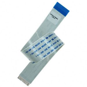

pati po pla ribbon cable napalitan ko n rin,..sa module n po b ito?salamat

for the Ribbon wire or FFC (fixed flexible cable) ay may dalawang klase... hope aware din tau nito. ung same end to end at saka ung baliktaran
