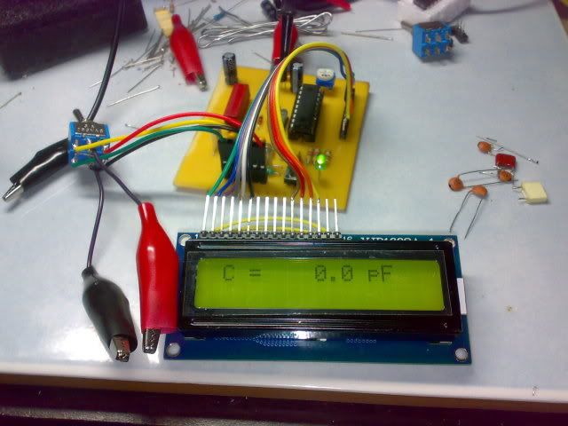

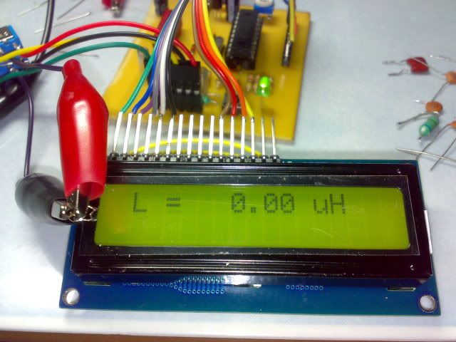

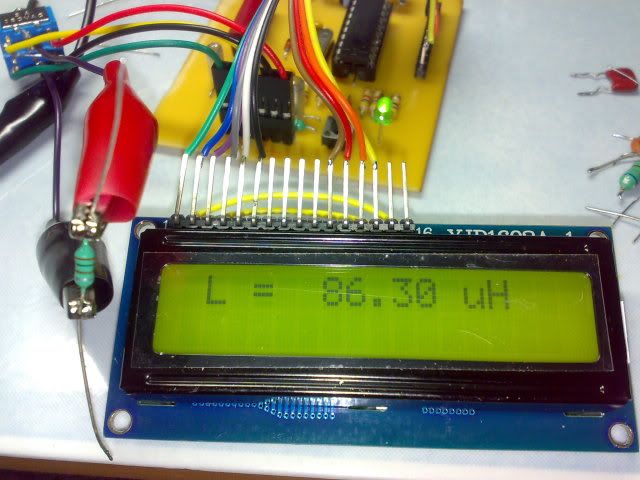

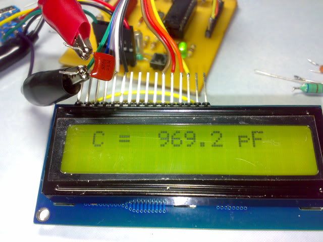

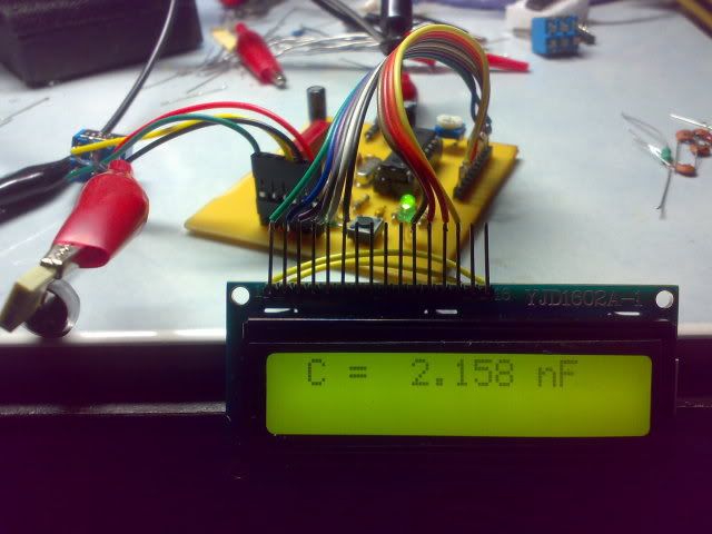

For those who are into prototyping, design and repair job particular on RF circuit this is a must have gadget for you!
PIC Digital LC Meter:
This is one of the most accurate and simplest LC inductance / capacitance Meters that one can find. This LC Meter allows you to measure incredibly small inductance starting from 10nH to 1000nH, 1uH to 1000uH, 1mH to 100mH and capacitance from 0.1pF up to 900nF. LC Meter's circuit uses an auto ranging system so that you do not need to spend time selecting ranges manually. Another neat function is reset switch that will reset the initial inductance / capacitance, making sure that the final readings of the LC Meter are as accurate as possible.
LC Meter's Technical Specifications:
Voltage Supply: 6 - 16V
Accuracy: 1%
Full Automatic Ranging
Inductance Resolution: 10nH
Capacitance Resolution: 0.1pF
LC Meter's Inductance Measurement Ranges:
- 10nH - 1000nH
- 1uH - 1000uH
- 1mH - 100mH
LC Meter's Capacitance Measurement Ranges:
- 0.1pF - 1000pF
- 1nF - 900nF
Prototype:
"L" or Inductance Mode:
"C" or Capacitance Mode:
