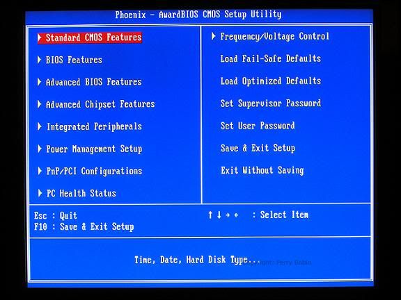

Post by korey18 on Fri Nov 11, 2011 11:37 am
READ AND UNDERSTAND... :|
hOPE YOU CAN FOLLOW THE STEPS.. Surprised
1) All computer has BIOS ( Basic input/output system). Here, you can set up how your PC will run. It is a blue colored full screen with different tabs like general, exit, devices and many more. Go to BIOS by simply hitting del (delete) continuously after restarting your computer.
2) Once in BIOS, look for the booting set up. Listed there are the devices which computer normally boots. ( Harddisk, CD-rom, Floopy Disk and Network)
3) Place the CD-Rom as the first boot and see to it that the bootable CD of Operating system you want is inserted in the CD-Rom. Then Place harddisk as the second booting device. Third and fourth booting devices are not usually important.

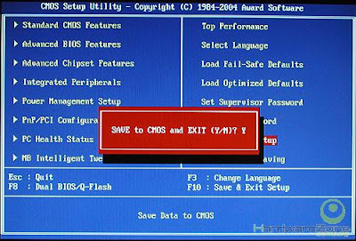

4) Save the changes and Exit. This will restart your computer automatically.
