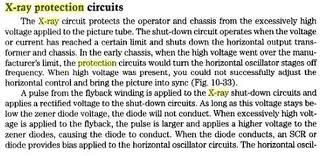

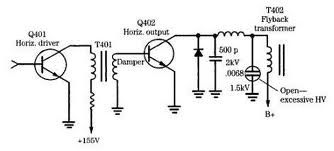

x-ray protect is one of the televisions protection circuit to sense the excess voltage or current to stop and shutdown the hor osc from continuous oscillation to prevent from excessive emission of high voltage on the CRT.it is being located on ps section or some where that monitor the excess voltage or current supply by the regulator

@Electro sori mali akng naipost ko.. tama sila X-ray protect yan...\
