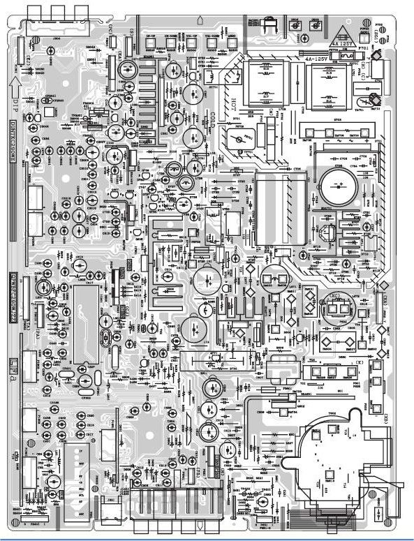

Sharp TV ( Chassis GB-3' 1W ) Eboard: DUNTKC290WE
Sharp TV
32C540
Chassis GB-3' 1W
Eboard: DUNTKC290WE, QPWBFC290WJZZ
Reg - SPA11N603, STP11NM60FP
Pwm - TEA1533A
EEPROM - BR24L16F
System Con - IXB418WJ
Jungle - TB1253AN
PIN Amp - BA15218F
AV SW - CXA2089Q
MTS - CXA2194Q, CXA2074Q
DIG. COMB - TC90A35F
Sound - AN5277
RGB - TDA6103Q
Vert - TDA8177, LA78041
Hot - D2581, D2646
FBT - FA038WJ, RTRNFA038WJZZ
To enter the service mode and exit service
mode.
To enter the service mode manually just press and hold
the Vol-down and Ch-up buttons at the same time, plug
the AC cord into a wall socket.
Now the TV set is switched on and enters the service
mode.
To exit the service mode, turn the television off by
pressing the power button.
