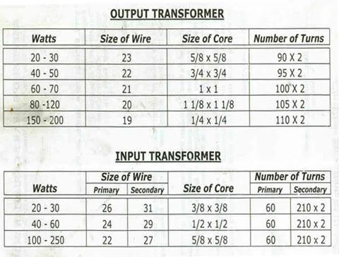

Pa help mga master. About 50+50 watts audio booster
Post by geof79 on Thu Dec 03, 2015 7:46 am
Ask ko lng mga sir un winding ng input at output transformer kung ilan turns. My nkgawa nb ne2? Gus2 ko lng mgsarili gawa. Tnx..

Post by Hertz on Sat Dec 26, 2015 11:44 am
Ito makatulong ito sayo

Post by geof79 on Tue Jan 05, 2016 1:49 pm
Slamat d2 master. Ngaun lng ulit nkpg ol.
