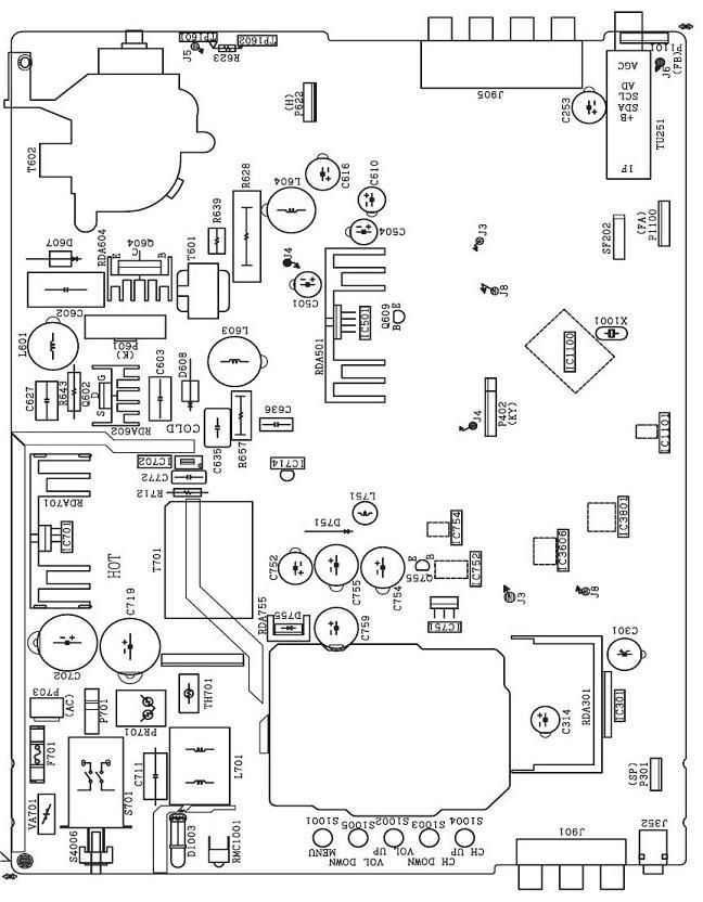

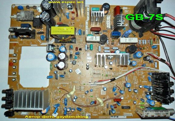

Sharp TV
29S-FX10U
29F-PS370
Chassis GB-7S
Eboard: DUNTKE474WE , QPWBFE474WJN1
Reg - STRW6556, STR-W6556A
EEPROM - M24C16W6
UOC - IXC123WJ, TDA12156H1/N2/3
AV SW - NJM2701M
RGB - TDA6107A
Sound - LA42102
Vert - LA78045
Hot - C6089
FBT - FA141WJ, RTRNFA141WJZZ, JF0501-38524
Tuner - QA039WJZZ, TAEA-G018D
To Enter Service mode:
Press and hold the local key "VOL DOWN" & "CH UP" when power on the main switch
