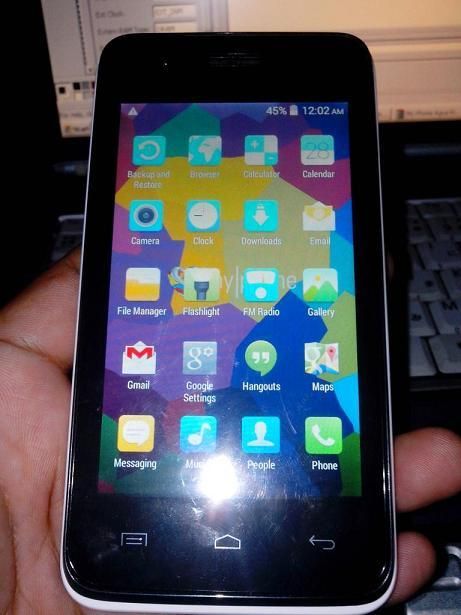

ang phone nato ay Hindi makatanggap ng Message pero nakakatanggap ng Call...
So unang ginawa ko ay sinubukan munang E factory Reset by pressing/holding Volume up & vol down
pero So sad.. Error xa at walang available na Recovery Files
So no choice na akng mag proceed sa Pagreflash ng Firmware nya...
at ayun na swak nga...

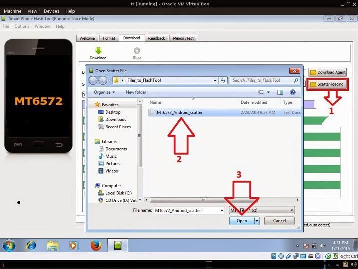

eto ang mga Requirements:
* Drivers - All MTK USB Driver_.9.2+PDanet+Adb Installer
* USB cable
* Flasher - SP Flash Tool v5.1352.01
* Firmware - Rio_Craze_20140722_V1.14
Extract nyu muna ang Compilation Rar – Myphone Rio Craze Flash File
Sa Pag Flash "Your Phone must be turned off when you are ready to connect and flash your phone"
Pasok muna kau sa SP Flash Tool v5.1352.01 Folder
1.Click/Launch FlashTool (flash_tool.exe)
2.In Flashtool, Click on Scatter-Loading, and load your scatter file.
Hanapin nyu sa compilation natin ang “MT65xx_Android_scatter_emmc.txt”
3. After you Load the file, press Download to Flash your Phone.
4. After you press Download Follow these steps
* Turn off your phone (always powered off is a must)
* Press and HOLD volume UP or Down or you can simply press it simultaneously
* Insert your USB cable without releasing the VOLUME button(s).
* Keep on repeating until Flashtool detected your phone.
   Dito pwede na wag nyu ng e press ang mga Volumes.. tanggalinnyu lng ang battery nya at saksak nyu lng ang usb cable. kusa ba xang magdedetect...
5. If successfully detected just wait until the progress bar reaches 100%. Hanggang sa lumabas ang Green Check
If your phone did not automatically turn on after flashing, remove battery and USB cable. And put back your battery then turn on your device.
Sa unang bukas medjo matatagalan yan. kaya wait lang kau...
Hanggang sa mkapasok kau sa wallpaper

Bali ganito ang hitsura nya pag ok na at validated na ang IMEI nya
