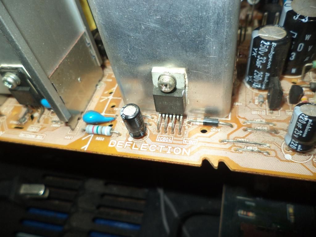

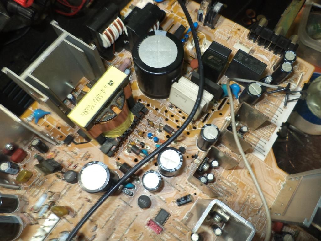

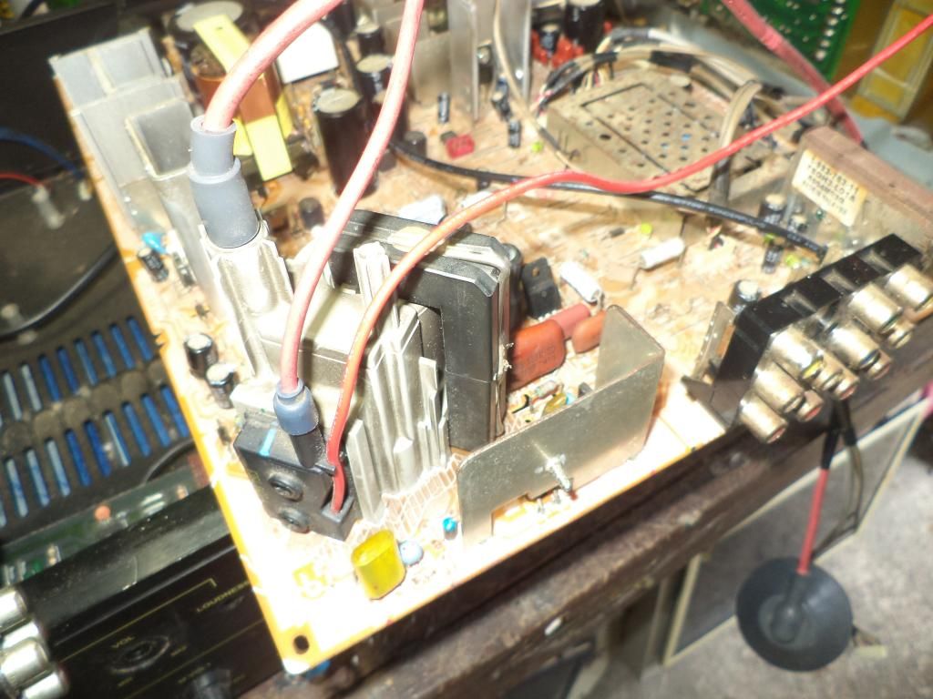

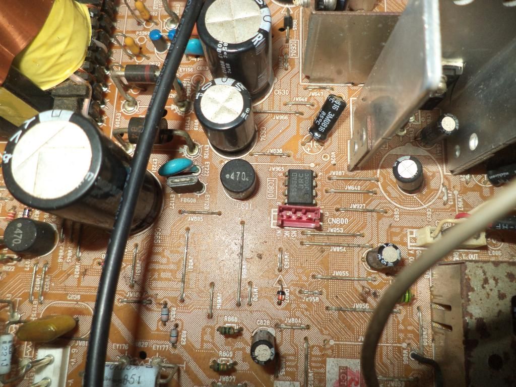

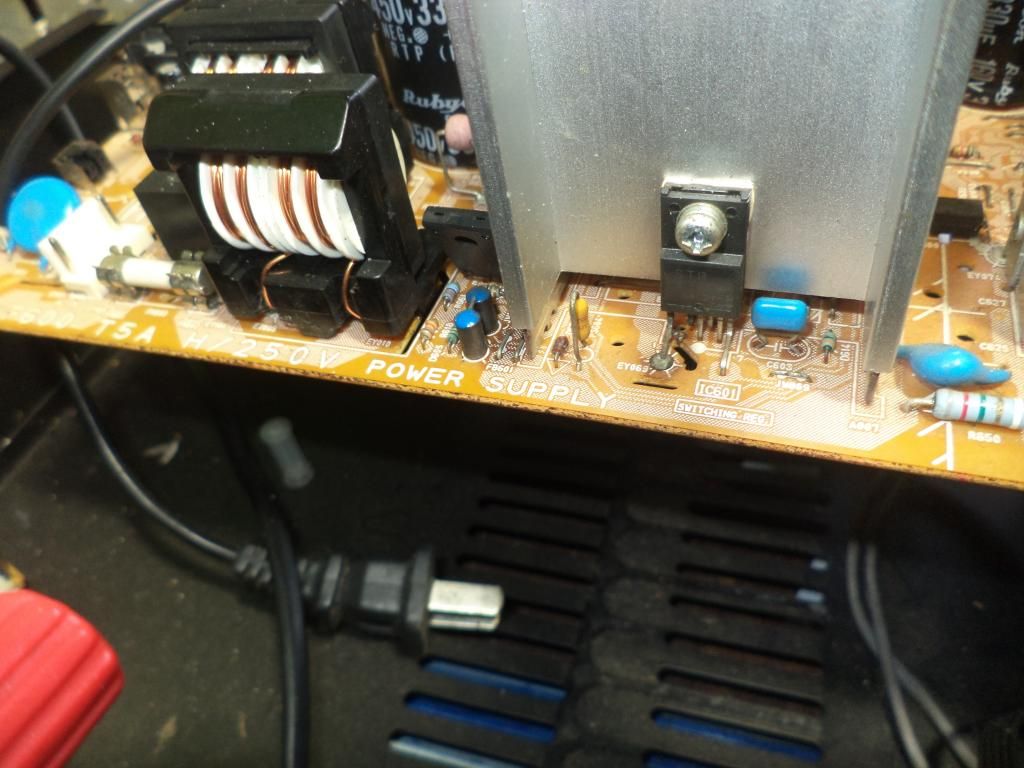

Post by DJFEL on Mon Jan 12, 2015 8:22 am
eto yong bord..
