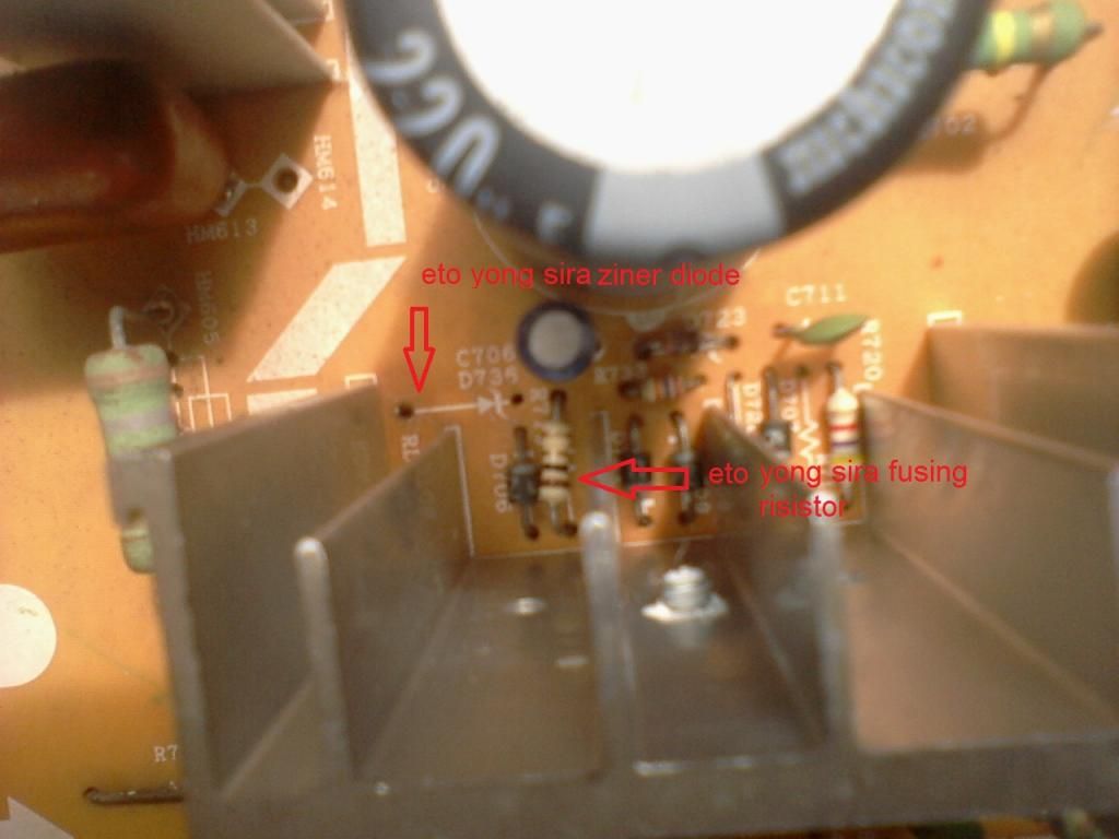

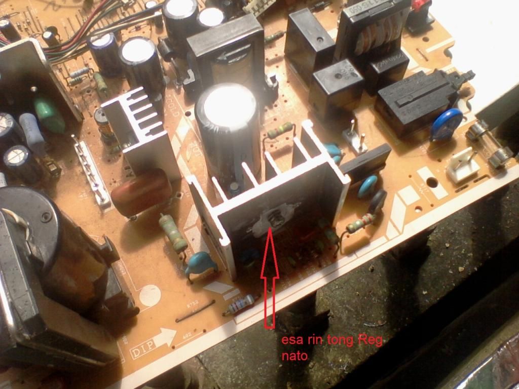

tatlo ang na kita kong sira...lahat nahalongkat ko na..sana eto lang ang sira...mahal kase tong REG na to sa amen...STR W5453A
Eto yong sira nasa pic..
Re: Sharp 20V-R70M NO POWER
Post by DJFEL on Sun Sep 28, 2014 5:16 pm
ziner diode,fusing risistor at str ang sira neto

sana nga...nasa 370 kase dito yong reg...baka wlang mang short neto pang sinampak ko yong new reg nito..

Post by DJFEL on Wed Nov 05, 2014 9:06 am
ok nato mga sis...tnks sa replay..
Post by DJFEL on Wed Nov 05, 2014 9:38 am
DJFEL wrote:ok nato mga sis...tnks sa replay..
eto yong sira...
4pcs ziner diode
1pc risistor
1pc reg
primary section lahat...
