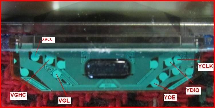

LCD 11M012CCA1
Zoom in

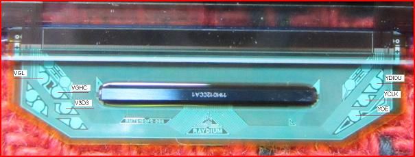

SAMSUNG
PANEL LTA320WT-L06
TOP 742PPTSFP-A01
Zoom in

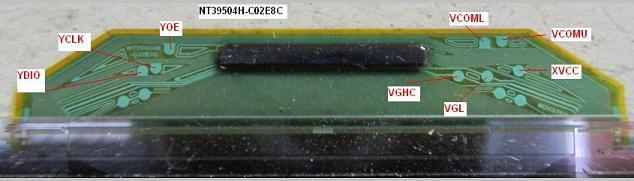

PANEL T315HW04
TOP NT39504H-C02E8C
Zoom in

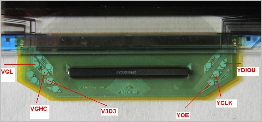

PANEL LTF320AA01 LTA320AA03
TOP 802PPTK54-A01
TCON 320WTS2LV2.7
Zoom in
