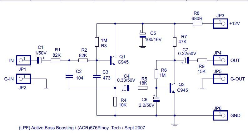

Post by ultrasonic™ on Tue Jan 28, 2014 7:36 pm
X-Bass Booster Using Transistor
courtesy of Sis PT ng Elab  ^_^

@ultra,pno setup nito sis?my nagawa ako nto dati[sariling design ko lng Very Happy ].medyo nawawala yong high ng output pagnakakabit to.nakaparelel kc sa tone circuit.nagtry rin akong don ikabit sa volume control,gnon pa din. apologies

replaced c4 from .33 to 1uf and c2 from 104 to 104X3.. kickass na via transformerless 2955..
