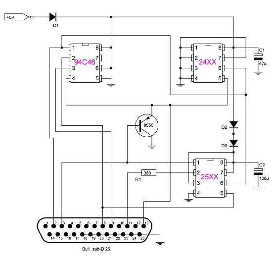

Post by Hertz on Fri Dec 06, 2013 1:26 pm
D1-D3 = 1N4007
Q1 = S8550 / A1015
24cxx, 25xx, 93cxx Parallel Programmer

Post by Digitap on Wed Aug 06, 2014 12:17 pm
puede pa i improve iyong programmer. add ng buffer mas bibilis ang speed niya

Post by james on Tue Aug 19, 2014 6:31 pm
Pwede kayang gawing usb ang interface?
Re: 24cxx, 25xx, 93cxx [ Parallel programmer ]
Post by Hertz on Thu Sep 04, 2014 7:06 pm
hindi. dahil buong circuit na ang mababago. Create na lang tayo ng bagong thread para sa usb

Post by vintot26 on Mon Oct 27, 2014 12:49 pm
sir hertz nakagawa na ako nito tanung ko lang po panu po paganahin sa sa 24cxx dko po kc mapagana gamit ang ponyprog tia
