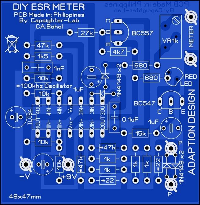

Post by DJFEL on Mon Feb 08, 2016 7:17 pm
eto na yong ESR miter ko...
pcb design by caspir lab

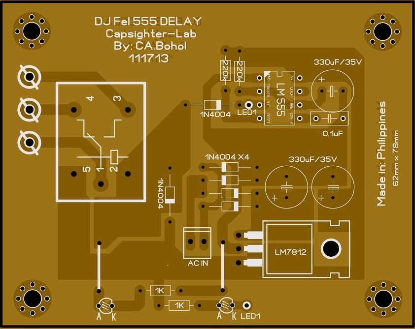

Post by DJFEL on Mon Feb 08, 2016 7:19 pm
555 delay...protic po hinde ma sira yong gamit nyo...

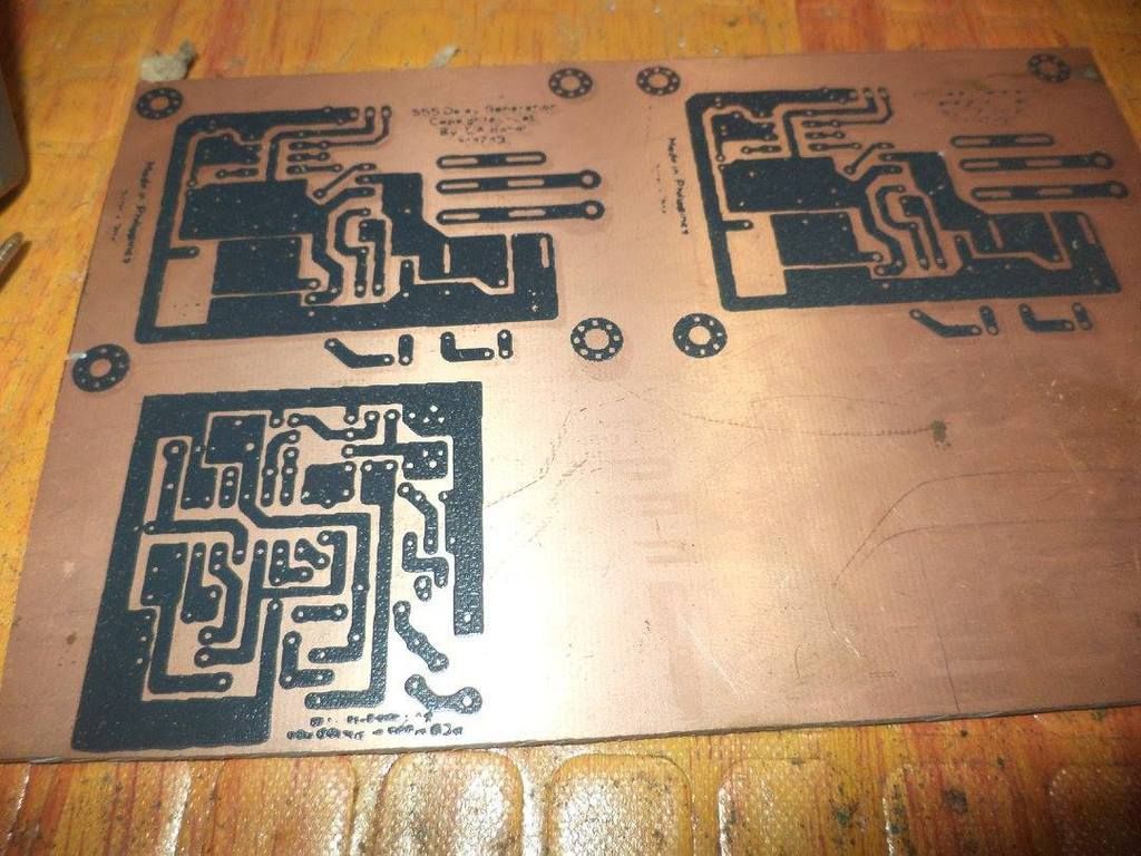

Post by DJFEL on Mon Feb 08, 2016 8:46 pm
eto na sis..

Post by alvinquimbo on Mon Feb 15, 2016 4:49 pm
sis pwede pahingi ng DIY esr meter mo??at saka sis gumana nayan sis yung esr meter..??
Re: Eto mga semply DIY ko at eba pa..
Post by DJFEL on Tue Feb 16, 2016 7:36 am
yaps gomana nato sis..pm kita sa fb mo..
