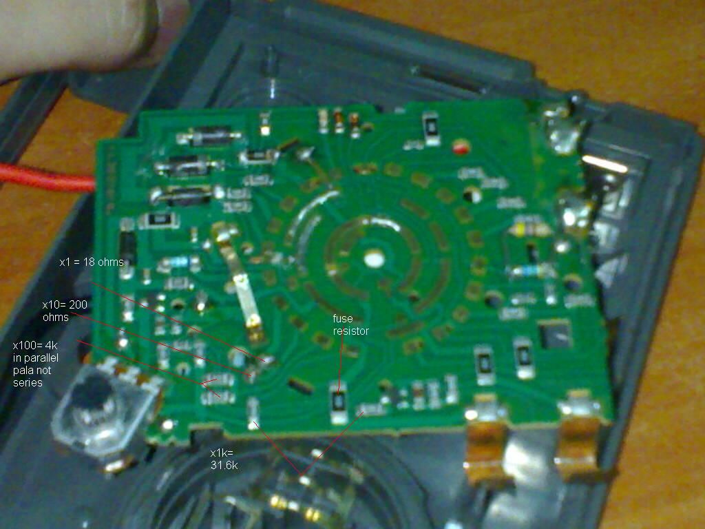

Post by DJFEL on Mon Nov 25, 2013 6:59 pm
ano kaya value netong dalawa nasa picture...sabog yan...nahagilap sa HV yong x1....eto nang yare...hohoho..

Post by DJFEL on Mon Nov 25, 2013 9:41 pm
okis sis...ka gabi pa to nang sirvce ako...yong nang ma dale...naka x1 pala...yon sapol...

Post by Hertz on Tue Dec 03, 2013 5:43 pm
parang 9313 = 931k

Post by Electro on Sat Dec 07, 2013 12:58 pm
dalawang 9313 na nakaseries nga yan master. kakabukas ko lang ng tester ko Smile

Post by ultrasonic™ on Sat Dec 07, 2013 6:43 pm
huli na pala ako ^_^
hulaan ko nlng... going to Base ng Tranny ata yan  ^_^

Post by triac on Fri Feb 07, 2014 6:50 pm
malaking tulong po ito sir ultra +1 point po.Tanong ko lang po,itong x100 dalawang 4k po ba?at ang X1k dalawang 31.6k po ba?salamat.. Very Happy

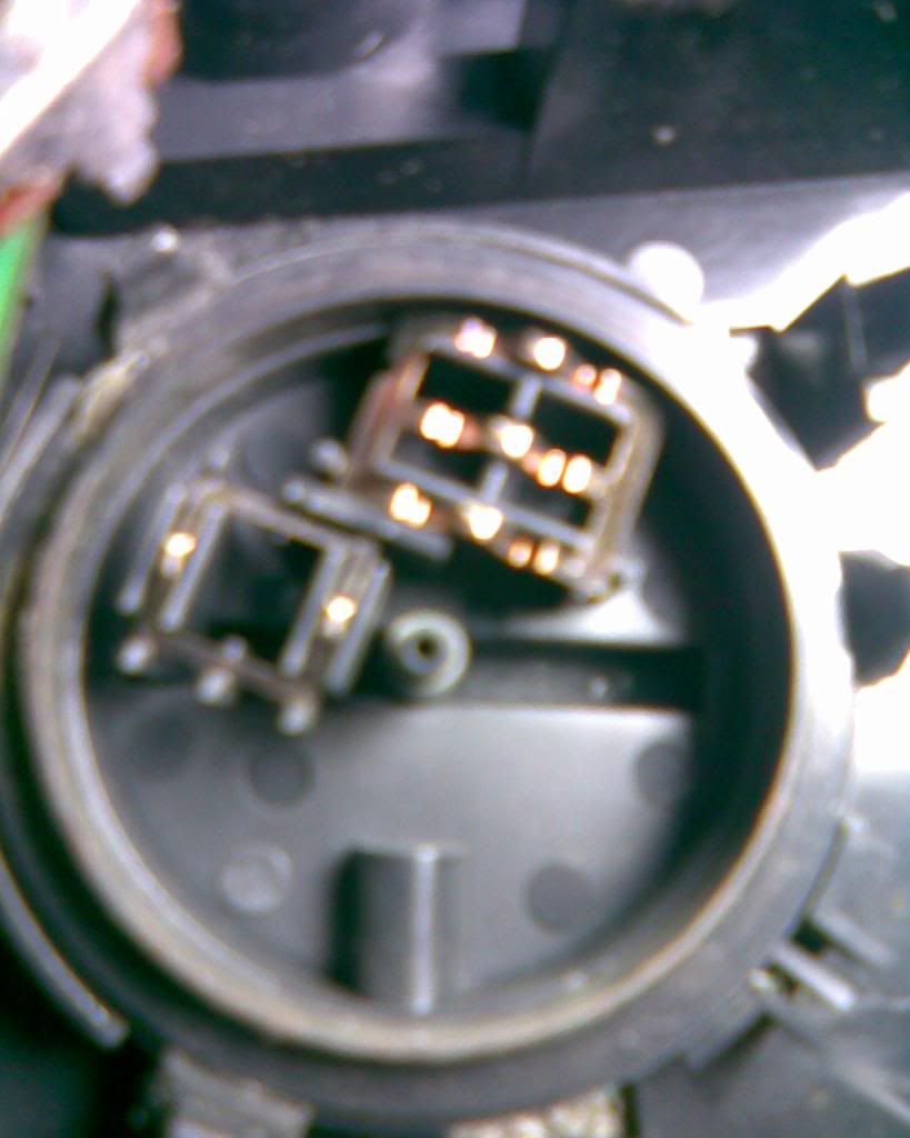

Post by DJFEL on Tue Mar 11, 2014 6:27 pm
tnks po sa lahat as-in..
my esa naman probs..shear ko lang yong pic..
ako kaya pisa nito..piro ok naman lahat 1x to 100k...

Post by DJFEL on Tue Mar 11, 2014 6:35 pm
pa shear nang pic sis ultra eto pala yong na wla...
